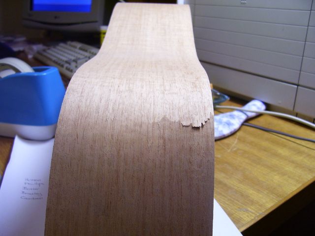

Thank you one and all for your replys. You have answered all my questions and a couple of others I hadn't thought of . However my plan to assemble the box this week has suffered a major setback with a cracked side .  While trying to fit everything together in the body mold I was a little careless and paid dearly for it. Is there any point in trying to repair this type of damage? Regards
Craig.
PostPosted: Sat Jul 14, 2007 9:01 pm
Craig that looks easily repairable, it just need gluing down with a shaped caul on both sides, then sanding out, final sanding will probably take care of it.
You already have an outside caul ready shaped, your mould, make up an inside shaped caul, bit of glue, I'd use fish or hide but AR glue will do, some even use that awful CA stuff, bit of wax paper so you don't glue your sides to the mould, then clamp it all together nice and tight to close the split.
PostPosted: Sat Jul 14, 2007 11:50 pm
Joined: Wed May 30, 2007 4:29 pm
Posts: 188
Colin that's encouraging news for me. My concern is that I need to touch up the waist and upper bout bends on both the sides as they have sprung back noticeably.  Strangely the lower bout bends have not moved. Should I glue before I attempt this or after?

PostPosted: Sun Jul 15, 2007 1:36 am
Joined: Tue Mar 20, 2007 3:45 pm
Posts: 206
I assume you'll be using heat to rebend, I'd do that first and glue after, as the heat will weaken the glue used to repair the crack.
